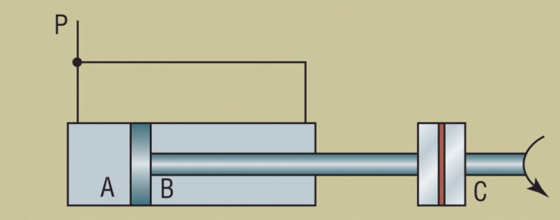

Figure 1. Hydrostatically balanced cylinder loading two lubricated surfaces.

Hydrostatic force is the product of pressure and area. Expressed mathematically: F = P × A. The balancing of hydrostatic force is achieved by exposing opposing areas to the same pressure. The double-acting cylinder in Figure 1 illustrates this concept.
Figure 3. Loss of hydrostatic balance increases load on the lubricated surfaces.
The rod-side area of the piston, area B, is 80% of area A. This means the force exerted on the lubricated surfaces at the end of the cylinder rod is 20% of the force developed by the pressure acting on area A. This is due to the offsetting force developed by the same pressure acting on area B. Assuming the speed of the rotating surface, C and fluid viscosity are adequate, full-film lubrication of the sliding surfaces is achieved.
