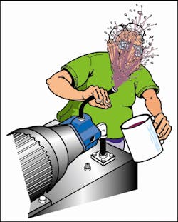

Figure 1. A dangerous example of testing pump and relief valves, in which hydraulic fluid could spray out of an open reservoir and hose.
Pump or relief valve?
The booklet recommends, “If high pressure cannot be obtained by running the pump against the relief valve, further testing must be conducted to see whether the fault lies in the pump or in the relief valve.”
You should then proceed as follows: “If possible, disconnect the reservoir return line from the relief valve. Attach a short length of hose to the relief valve outlet. Hold the open end of this hose over the reservoir filler opening so the rate of oil flow can be observed. Start the pump and run the relief valve adjustment up and down while observing the flow through the hose. If the pump is bad, there will probably be a full stream of oil when the relief valve adjustment is backed off, but this flow will diminish or stop as the adjustment is increased. If a flow meter is available the flow can be measured and compared with the pump catalog rating.”
This is an outrageous recommendation from a safety point of view, as seen in Figure 1. It contains too many unknowns! How much flow? Could the hose whip out of your hand? What if the oil flowing from the open hose strikes the top of the reservoir and sprays into your face? What is the temperature of the oil?
The booklet continues: “If a flow meter is not available, the rate of flow on small pumps can be measured by discharging the hose into a bucket while timing with the sweep hand on a watch. For example, if a volume of 10 gal is collected in 15 seconds, the pumping rate is 40 gpm, etc.”
Once again, you are discharging an unknown amount of oil at an unknown temperature to atmosphere — another fallacious recommendation! Plus, it is technically wrong — it is physically impossible to properly test a hydraulic pump at no load (low pressure).
