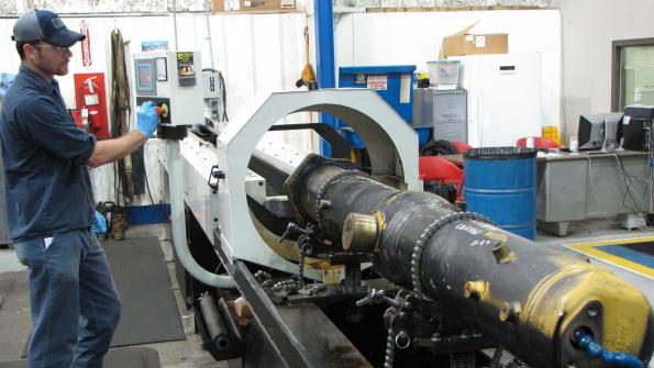

Whayne honing operator changes abrasives to perform both roughing and finishing of the bore.

"We were not sure about downtime for a new machine, but it has proven extremely reliable and we've used it to hone cylinders from 2.5 to 17 in. (63.5 to 432 mm) diameter, and 6 in. (152 mm) length to over 21 ft (6.4 m)," Carter added. "We simply created a table with an adjustable-height V-block to support parts that overhang the machine. We have used up to a 21-foot drive-shaft length on the machine, and we can hone from both ends of the part if need be. Our cycle time for most barrels is about 30 minutes, which includes setup, honing and washing the part."

Whayne uses both roughing and finishing abrasives, removing scratches and rust, and imparting a specific crosshatch surface finish on the barrel bore. "We can increase the cylinder bore diameter up to 0.254 mm (0.010 in.) in relatively short time, removing rust and all but the worst scratches, and remain within Cat machine specifications," Carter said. "Our old hone simply could not do this. The HTA hone is easy to setup also. The control calculates the correct cross hatch angle. It's been a very reliable system, too, with no appreciable downtime.
