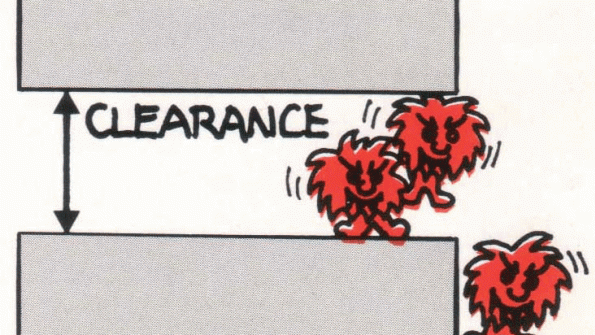

Figure 1. Particles larger than a component’s internal clearances are not necessarily dangerous.

Hard particles accelerate wear of hydraulic components. The rate at which damage occurs depends on the internal clearances of the components within the system, the size, shape and quantity of particles present in the oil, and operating pressure.
Particles larger than a component’s internal clearances, Figure 1, are not necessarily dangerous — unless they cause interruption of hydrostatic balance, i.e. blockage of balance drillings. Particles the same size as the internal clearance, Figure 2, cause heavy friction and wear through a process known as three-body abrasion.
