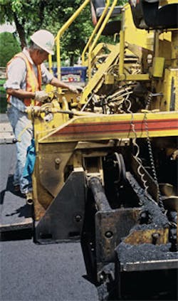

Applying Pareto’s Law to your maintenance program for hydraulic hose can help you reduce downtime and save change-out and replacement costs in the long run.
