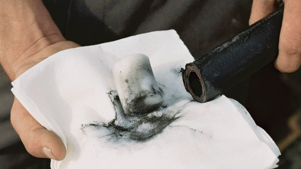

The Ultra Clean ejected projectile shows the residual rubber dust, flakes of metal and scale whisked away out of the hydraulic hose.

After the third failure, John Deere operators decided to employ a secondary method of decontamination. They flushed the hydraulic hose and tube assemblies, then cleaned them using the Ultra Clean System, which uses a dry method of cleaning hoses that employs a pneumatic launcher to “shoot” a foam projectile through hose and tube assemblies, dislodging and carrying away dirt, debris and contaminants, many “unseen” even within new and recently cleaned hoses.
The amount of rubber dust, flakes of metal, and scale clinging to the projectiles of the just-flushed hoses was surprising.
