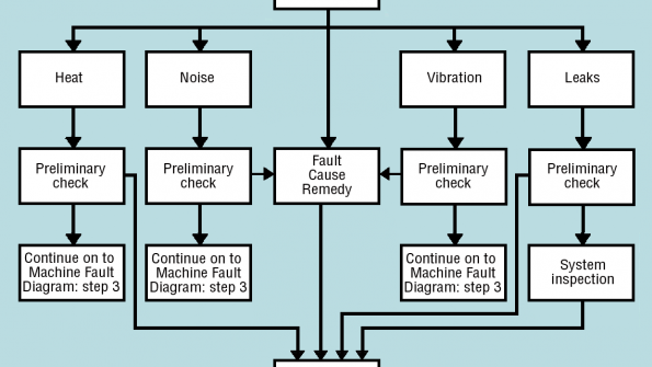

Effective and productive troubleshooting is not a complicated process.  Clearly, the first prerequisite is technical knowledge, but equally important is mental attitude.  In addition to understanding machine operation, as well as hydraulic components and circuitry, the individual must also have the training and discipline necessary to troubleshoot a hydraulic system in a logical and orderly manner.
Quick and efficient hydraulic troubleshooting requires that workers follow logical steps to locate malfunctions in the shortest possible time.  The challenge in resolving this problem consists of two steps:
  1. Think through and identify the elements that might contribute to a system malfunction.
  2. Avoid jumping to incorrect and illogical conclusions which may result in improper and inappropriate actions.

To relate the troubleshooting procedures described in these articles to an actual machine, consider a surface grinder in which the machine’s reciprocating motion passes a work piece back and forth under a grinding wheel. Proper operating requirements include:
  • accurate table inching for setup
  • variable table speed
  • smooth table reversal and intermediate stopping
  • control of grinding speed when travel direction is reversed, and
  • grinding motion in forward direction that is controllable to adjustable fixed positions.
Knowing the surface grinder’s performance specifications is a prerequisite to successful troubleshooting.  The machine malfunction procedure, which will be discussed in the next installment, provides a logical sequence of thought and action, which can be applied to the surface grinder or to any other hydraulic machine that develops a malfunction.
Coming next: Identify the machine malfunction and the components that might be the cause.
