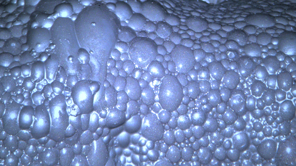

Aeration: a Different Scenario
Aeration occurs whenever outside air enters the suction inlet of the pump. This produces a sound that is more erratic than that of cavitation; the whining sound may be augmented by a sound similar to marbles or gravel rattling around inside the pump. In addition, oil in the reservoir may exhibit excessive foaming. Air in the oil can cause sluggishly operation and can damage the pump and other system components.
Pressure in the suction line is lower than that of the atmosphere, so any leaks in the suction line will not leak oil; instead, air will leak in. If you suspect an air leak, squirt oil on all the fittings and connections in the suction line. If the sound of aeration stops briefly, you have found your leak. An ultrasonic gun also can be used to detect leaks.

Also, a leak in the shaft seal can cause aeration by allowing air to enter the low-pressure section of the pump from the atmosphere. If you suspect a bad shaft seal, spray some shaving cream around the seal. If the seal is leaking, voids in the shaving cream will develop as air enters the pump. This problem came to light when I was called to a paper mill, where foam came out of a log-kicker’s hydraulic reservoir shortly after the machine’s fixed-displacement pump was started. After performing the shaving cream test, I knew the shaft seal was badly worn. Upon further inspection, I found the pump elastomeric coupling was worn, causing wear on the shaft seal.
