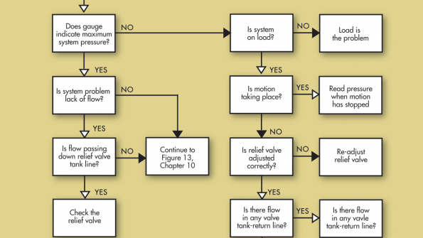

Figure 12 – Suggested troubleshooting procedure for hydraulic relief valves. Click on image for larger view.

Referring to Figure 12, the troubleshooter should install a pressure gauge at the upstream test point – if one is not already in place – to determine the maximum pressure at which the system will operate as controlled by the relief valve.  Many makes of relief valves provide a port in the valve to connect a gauge.
Figure 12 provides simple and quick means for determining if the problem is with the relief valve or elsewhere in the system.  If the troubleshooter determines that the problem is in fact with the relief valve, Figure 12 suggests possible causes of typical troubles.
