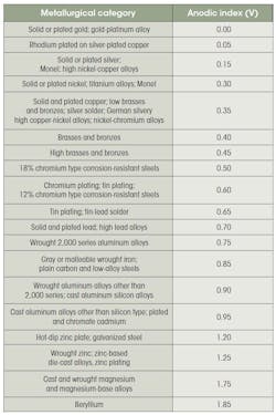

Metals contain thermodynamic energy—positive and negative charges—that is released by the process of corrosion. Metals are rated in their ability to resist electrochemical corrosion on the scale of nobility and on the galvanic series chart, which shows their electrical potential in seawater. More-noble metals (such as gold, silver, and titanium) have a neutral or negative electrical potential, so they will not generate a flow of positive ions. At the other end of the scale, more-active metals (zinc, aluminum, and cast iron) exhibit strong positive charges that tend to generate electrical current.
Click image to enlarge.
Galvanism occurs when two metals with different electrical potential are in close contact, creating a current flow. The resultant flow is very small in dry conditions, but when the metals are joined by water, the water acts as an electrolyte. This causes a significant increase in electron flow from the more-active to the less-active metal, resulting in metallic particles being deposited from the less- to the more-noble metal.

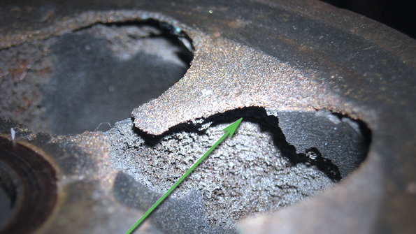

When iron and brass are in close contact with each other in a water-based solution, corrosion will occur. When the iron corrodes, it leaves large pitted, crumbling areas where the material has been removed.
Hydraulic pump suffered from galvinism and possibly electrolysis, causing large pitted areas.
The brass material shows signs of iron oxide (rust) growth, which can easily be seen with the naked eye. Brass contains no iron and cannot produce iron oxide on its own. Galvanic corrosion must occur for the brass to have iron oxide attached to its surface. In the particular instance above, the removal of the cast iron material directly under the brass wear plate has caused the brass wear plate to break away, owing to a lack of supporting material when under mechanical stresses. The relatively large pieces of brass were found mixed in a fine iron oxide sludge in the bottom of the pump housing, as would be expected for this type of corrosion.
If this damage had been caused by cavitation or fluid contamination instead, the brass material would be attacked at the surface and exposed to the pressure or contamination instead of the underlying iron.
