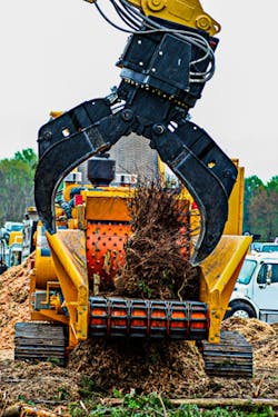

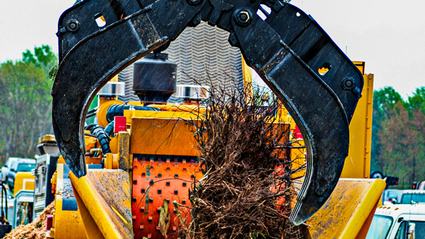

Water contamination of hydraulic oil plagued a subcontractor using excavator-mounted tree mulchers in Western Canada. The equipment regularly operated on uneven terrain, was subjected to heavy shock and vibration, long duty cycles, dirty operating conditions, and wide swings of ambient temperatures. Each mulching attachment tapped into the oil reservoir of the excavator driving it. Depending on the excavator, reservoirs ranged in capacity from 66 to 80 gal (250 to 300 l), and all machines used ISO 46 hydraulic oil.

Water getting into hydraulic oil caused problems in equipment used by a contractor to clear land for a construction project. A fluid-dehydration unit from Schroeder Industries resolved the problems and saved almost $10,000 in expenses for each of five machines.
