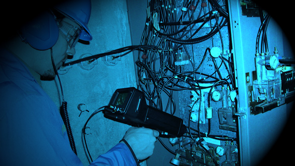

A leak-reduction program starts with a survey of the compressed-air system. Inspect during quiet hours. Listen for pipework or tool leaks, and examine hoses and couplings. A low-tech fix is to spray soapy water or other solution on pipe joints and watch for bubbles. A more effective method is to use a handheld ultrasonic leak detector. Outsourcing the inspection to a compressed-air auditing expert can also quickly pay for itself many times over.
Ultrasonic detection devices offer an effective way to find leaks in pneumatic components. They pay for themselves many times over in energy savings, serving as long-term tools for holding leakage at bay.
