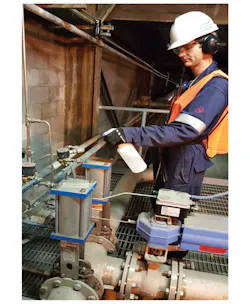

This view shows bubbles forming at a suspected leak site. The relatively large size of the bubbles indicates a substantial leak at low pressure.

Spraying a suspected leak area with soapy water can verify the presence and location of a compressed air leak if bubbles continually form at the site. Experienced practitioners can also assess the severity of the leak by examining the size of the bubbles.
Liquids—Liquid detectors are inexpensive and easy to use, but they can be more time consuming than, say, ultrasonic detectors. One benefit to liquid: it can often be purchased in a low-temperature version if leak detection is done outside in colder weather. Another benefit: bubble size can help determine the size of the leak.
