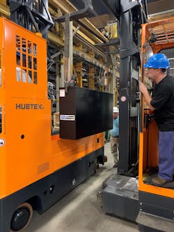

Off-highway industrial vehicles, such as forklifts, have been increasing the share of electric lift trucks for a few decades now, reaching 72% in the US in 2021, according to the Industrial Truck Association (ITA). Electric lift trucks are cleaner, less noisy, and more economical than propane- or diesel-powered forklifts, especially with the current high fuel prices.
Commercialization of lithium battery technology further accelerated the electrification trend in materials handling equipment. Lithium batteries enable the electrification of transport and industrial equipment, where traditional lead-acid batteries could not do the job: forklifts in power-hungry applications such as paper, lumber, metals, beverages, etc.; cranes and excavators in construction and mining; railway engines; boats; and even airplanes.
READ MORE: Construction Equipment Digs Deeper into Electrification
Companies see real savings and higher operational efficiency with the adoption of lithium batteries, and electrification is driven by the following key factors: better equipment performance, the lower total cost of ownership, the infinitely more advanced data capabilities provided by monitoring systems, and the ability to “communicate” with the battery. Real-time data collection, remote monitoring, predictive maintenance, troubleshooting, optimized charging, etc., are all easy to achieve with lithium batteries.
Lithium allows for regenerative braking, where braking energy is converted to recharge the battery. In lead-acid batteries, this was very much limited, when it was even possible.
The safety of operations is also improved. In the case of material handling equipment, single-battery operation and zero daily maintenance have radically reduced the number of battery-related accidents and potential costs for business.
