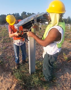

The goal was a flexible, easy-to-assemble array that could deliver the most electricity for the lowest cost. The result was the Sunfolding T29 Tracking array. Like other solar arrays, it is designed to be laid out in rows running from East to West with the photoelectric cells facing south to catch the sun from morning until dusk (in the Northern Hemisphere). To increase the amount of sunlight shining on the cells over the course of day, Sunfolding added a simple pneumatically powered tracking device that keeps the arrays pointed toward the moving sun.
The Sunfolding T29 uses AirDrive X actuators. Each contains two flexible air bladders—one to the West, the other to the East—sandwiched between two metal plates. The solar module mounts on the top metal plate. When the western bladder inflates, it lifts the west side of the panel and angles it towards the east, which lets it gather more sun in the morning. It then does the opposite toward sundown.
Single-axis trackers such as these generate 20 to 25% more electricity than static arrays, depending on geography and other installation factors. The question in the industry is no longer whether to use trackers or not, but which tracker is most profitable.
On the Sunfolding T29, a Tracker Controller controls the air pressure into and out of the 50-lb AirDrive X so that it points the modules toward the sun. The controller has an algorithm that determines the sun’s position in the sky during the day so it can aim the modules accordingly. A controller on end of each row of modules handles the entire row.
Compressed air comes from Sunfolding’s Supply Air System (SAS). It has a single air compressor and can handle modules or panels that generate from 4 to 6 megawatts of electricity. So, for example, a 50 MW solar farm might need 10 SAS. The compressor consumes a negligible amount of electricity in terms of cost, according to Sunfolding. They also use air as the working fluid, a readily available material that’s free of charge and can be vented to the atmosphere. The SAS’s are delivered from the factory as pre-assembled plug-and-play units that get dropped in place near the inverter.
