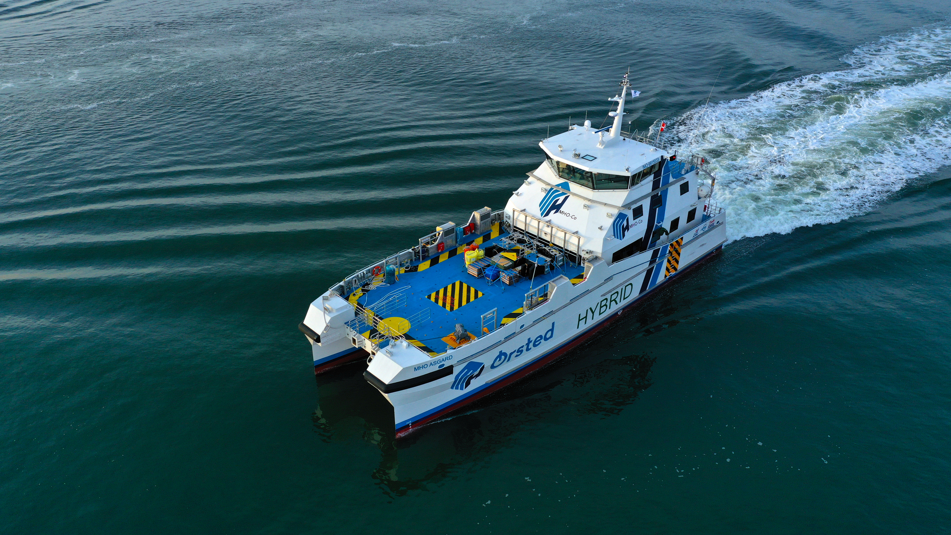

Volvo Penta and Danfoss’ Editron division have worked together to power two of the UK’s first fully integrated hybrid electric crew transfer vessels.

In March 2022, Danfoss Power Solutions’ Editron division announced it would provide components including electric motors for use in two new hybrid high-speed passenger ferries which will operate in central London. The ferries will be able to run on zero-emission electric propulsion and switch to biofuel.
Use of the hybrid powertrain enables the ferries to reduce their environmental impact without sacrificing performance. The ability to switch to use of biofuel will help maintain low emissions while ensuring the ferries can complete their routes. Operating range is often a concern for many when moving to electric powered vehicles, but a hybrid system ensures there is a backup or alternative power capability when needed.
Danfoss notes use of the hybrid system can help to improve comfort for operators and passengers as the ferry is able to run much quieter through use of the electric components. Maintenance is often reduced as well with electrification, as there are fewer moving parts and thus wear and tear is minimized.
