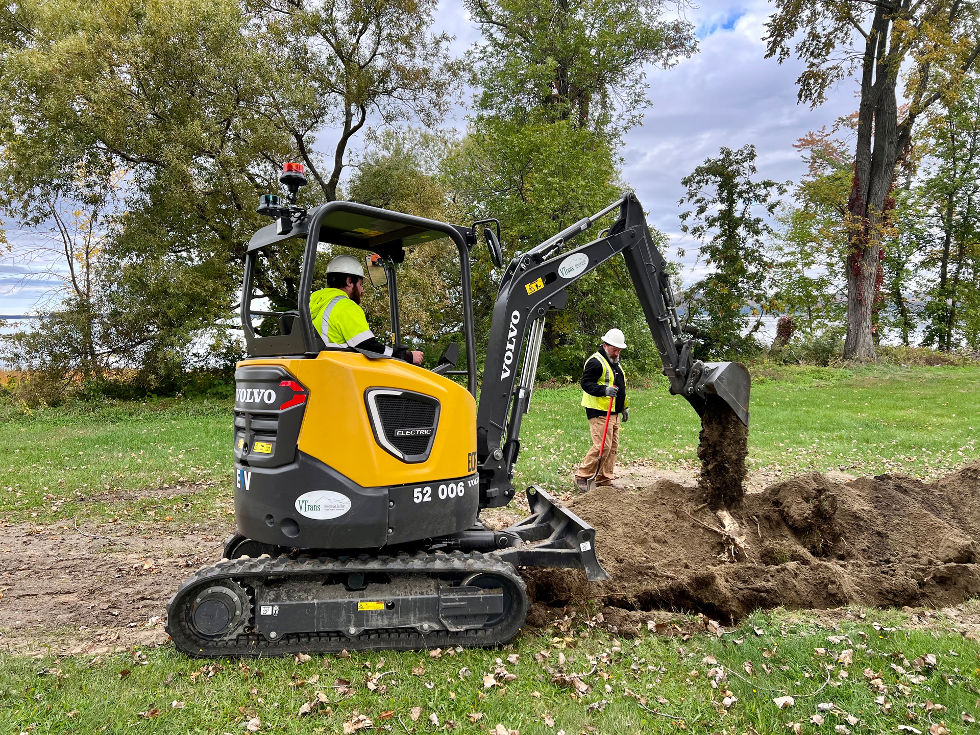

Currently, Volvo CE has five electric machines in its lineup which are commercially available – three compact excavators and two compact wheel loaders. Ray Gallant, Vice President Product Management and Productivity at Volvo CE, said during the press conference that feedback from customers using the machines so far has been good. They like that they match the performance of diesel alternatives while being quieter and emissions free.
In 2023, the company plans to introduce two new models its electric equipment lineup, a DCR 18 short swing radius 1.8-ton mini excavator and an EC 18 conventional swing small excavator. At the company’s CONEXPO booth it will also be showing its first electrified mid-range excavator, the EC230.
The 23-ton EC230 features a 600V battery and is Volvo CE’s first step into electrifying the rest of its range of larger equipment said Gallant. To date the excavator has undergone customer trials in Europe and in 2023 will undergo testing with customers in North America. The company is anticipating having the machine available for sale in 2024.
