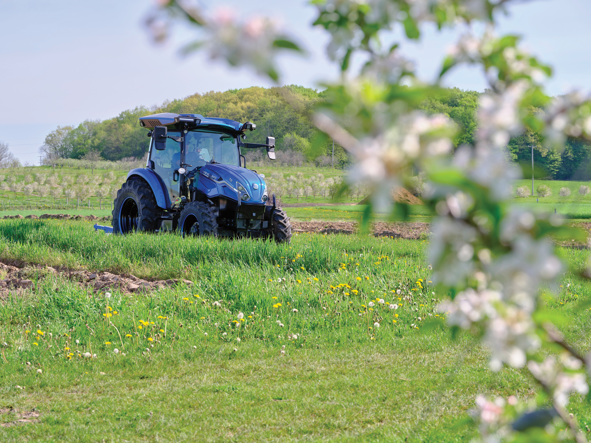

The T4 Electric Power utility tractor from New Holland Agriculture provides noise and emissions-free operation.

The New Holland T4 Electric Power is an all-electric utility tractor with autonomous features. According to the company, the tractor is designed to help create more efficient field operations for farmers.
A lithium-ion battery pack and full-electric drivetrain powers the tractor, delivering 74 hp (55 kW) rated power and 65 hp (48 kW) PTO power. The tractor is able to provide the same power outputs as a traditional diesel-powered machine while minimizing maintenance and fuel costs due to the use of an electric power system. As the tractor is intended for various low horsepower applications, it is estimated to provide 4 hours of average runtime. In low-energy demand applications, though, this could be extended up to as much as 8 working hours.
Per New Holland, the tractor features a rear electro-hydraulic PTO, drawbar, multiple rear remotes, mid-mount valves and a 725LU mechanical self-leveling front loader. The increased amount of electronics in the machine help to improve control and precision of machine movements, helping to reduce cycle times and thus increasing efficiency.
READ MORE: Electrohydraulics Benefit Tool Leveling for Telehandlers
Use of a quiet electric motor and replacement of the diesel engine enables the tractor to be used in noise sensitive environments such as in buildings or near animals and people.
