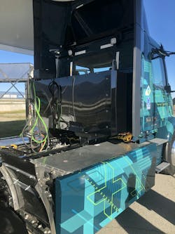

closeup of the battery system on an electric truck
