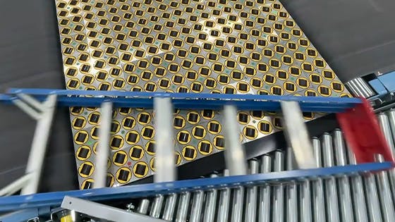

Robust Package Handling
Imagine trying to move a stepladder, rolled-up carpet, or mattress on a conveyance line. Most operations won’t even attempt this because they have no way to divert these items. Yet approximately 10% of all e-commerce orders involve large, irregular objects or parcels like these.
Until recently, irregular parcels needed to be handled manually by scarce and expensive labor. Steerable tables create new options for automating the handling and diverting of these items.

These items often required special equipment or hand-sorting before steerable tables became available. Today, steerable tables can handle items as small as 4 x 3 in. (100 x 76 mm).
