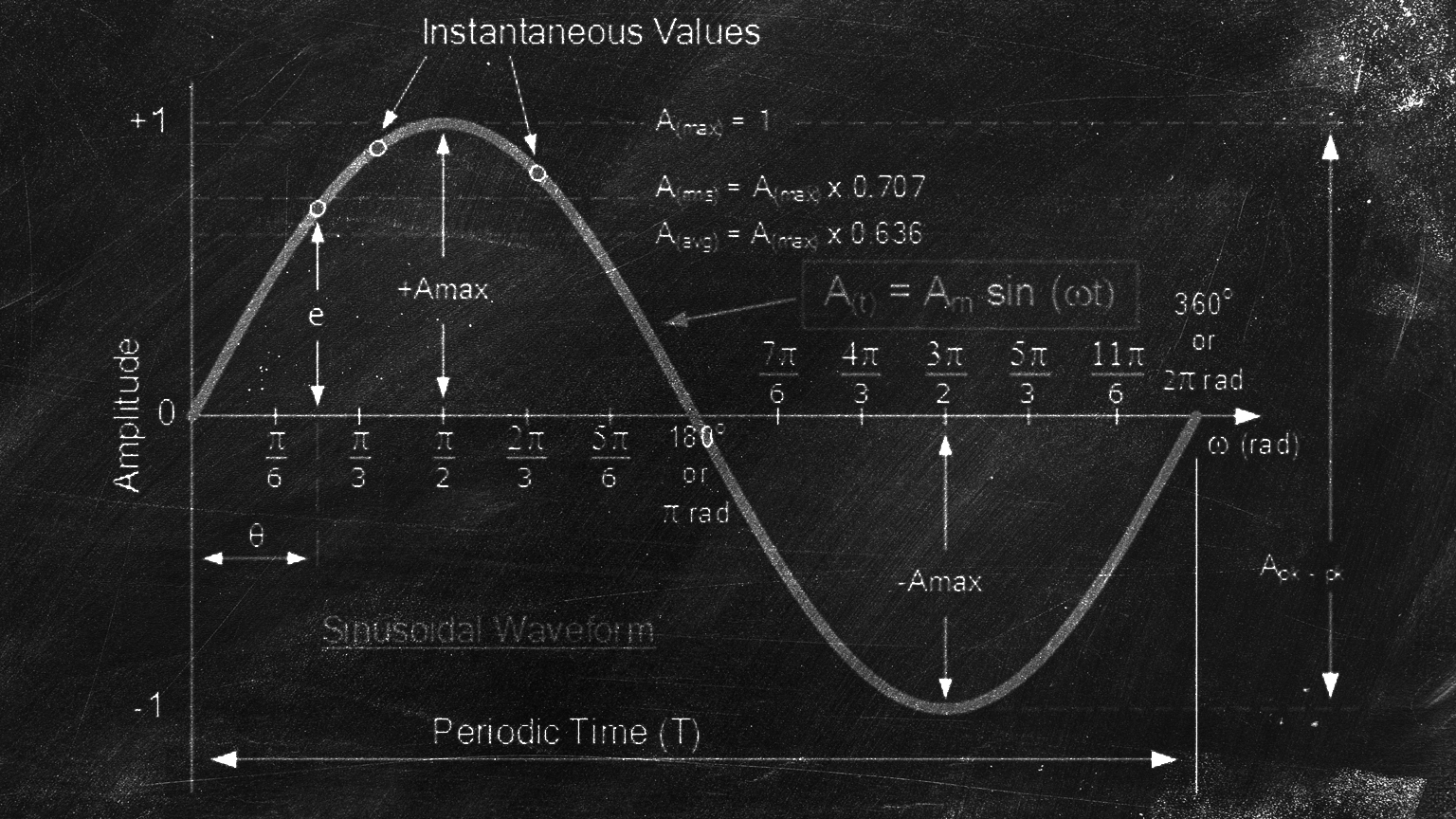

Many test systems use sine wave (sinusoidal) motion. Sinusoidal motion profiles are easy to generate because most computers and PLCs have sin functions either built in or as an additional library. However, generating the motion profile is not the hard part.
Basics
Too many times we have seen failed systems or been asked ridiculous questions because the designers didn’t fully realize the challenges of making sinusoidal systems. They usually look at the basic definition, which is:
position(t) = amplitude ⋅ sin(2π ⋅ Hz ⋅ t)
The frequency in Hertz (Hz) must be multiplied by 2π to convert Hz to radians per second for the sine function. This is easy enough.
The velocity should be calculated as well so the hydraulic designers can ensure the actuator will move fast enough. The velocity is easy to calculate using the definition of the derivative of a sine function
velocity(t) = amplitude ⋅ cos(2π ⋅ Hz ⋅ t) ⋅ 2π ⋅ Hz
The velocity as function of time should also be calculated for velocity feed forward (VFF) calculations.
The peak value of a sine or cosine function is 1, so it is easy to calculate peak velocity:
peak velocity = amplitude ⋅ 2π ⋅ Hz
The next step usually gets people into trouble. The acceleration is the derivative of the velocity:
acceleration = amplitude ⋅ (sin2π ⋅ Hz ⋅ t) (2π ⋅ Hz)2
The acceleration should be calculated so acceleration feed forwards (AFF) can be calculated, but the ‘gotcha’ is the peak acceleration.
Peak acceleration is:
peak acceleration = amplitude ⋅ (2π⋅Hz)2
Notice that the peak acceleration goes up with the frequency squared. This means a sine wave of 20 Hz has a peak acceleration four times that of a sinewave at 10 Hz. That means the system’s natural frequency must be four times higher and the valve must have a frequency response four times higher.
