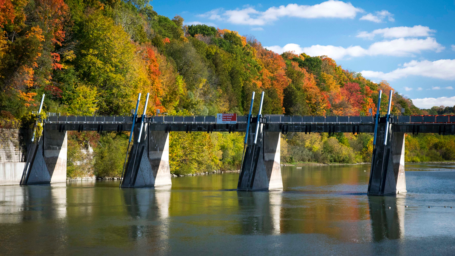

Water flow gates operated by hydraulic cylinders are critical to prevent floods and control water flow to electric turbines, so as to keep them operating without being damaged. Hydraulic locks can hold the gate at any position by stopping at any position along the actuator’s stroke when power is switched off or lost. It can then move in either directiongate open or closedwhen power is restored. This ensures safety is retained and property damage prevented.
Below are two water-gate control schematics with hydraulic lock, a crest gate mounted on the top of a dam sill and a wheeled vertical liftgate.
Areas with red dashed lines contain components the system depends on to lock a load in place or prevent drift when locked. In these illustrations, the lock takes the hydraulic circuit and power out of the equation for load safety and lockout. It also would hold the load even if the hydraulic fluid completely bled out and any or all the seals on the cylinder were damaged or lost. Only the cylinder body, rod and lock are needed to maintain the lock. Removing power engages the locking system; restoring power unlocks it and renews operation.
