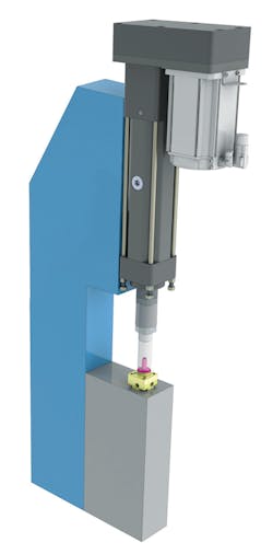

Electric rod-actuators are replacing fluid power actuators for many high-force applications throughout industry. Tasks once limited to hydraulic and pneumatic cylinders such as pressing, holding, lifting and spot welding are now handled by electric actuators, in part because of their lower life-cycle costs. What’s more, electric actuators’ speed, accuracy and flexibility can increase production and make machines more flexible and adaptable.

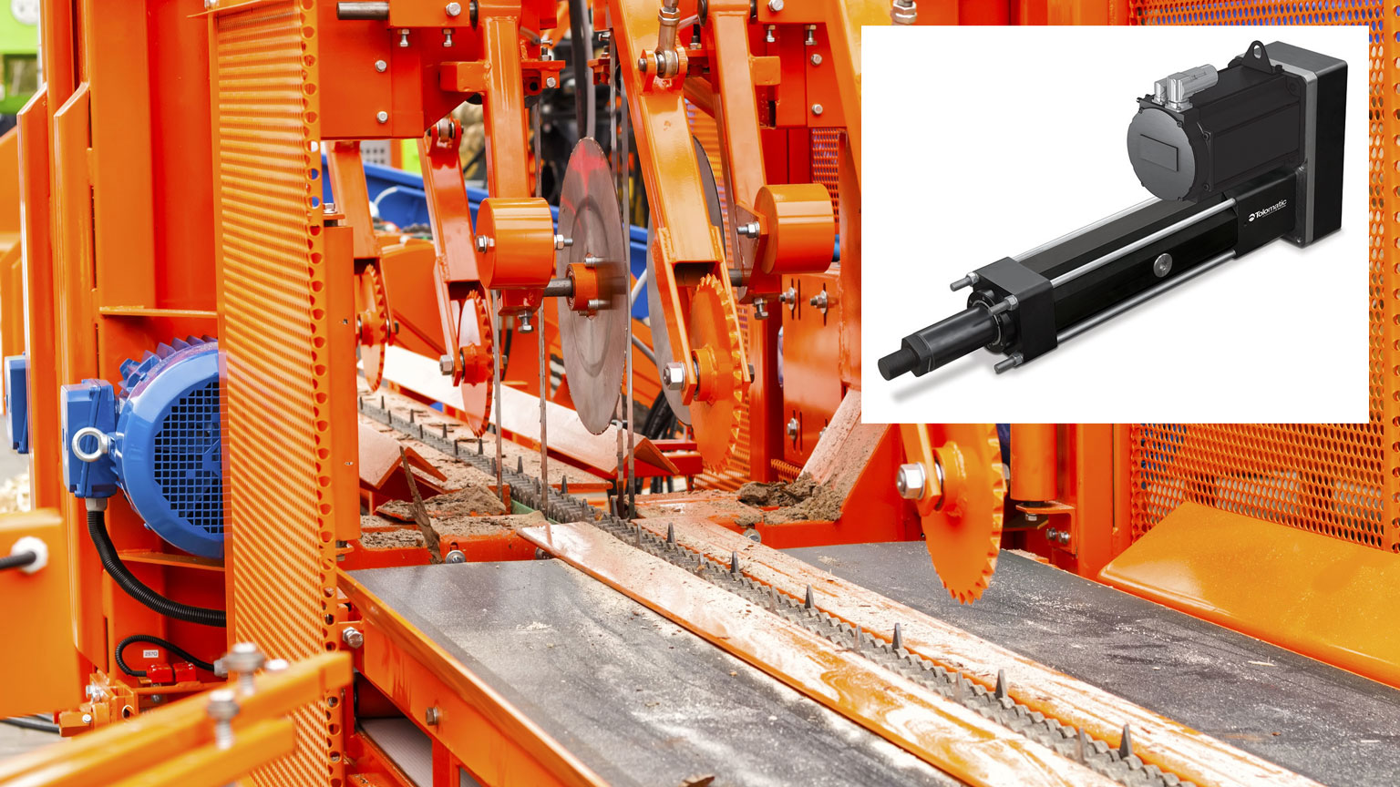

For example, a lumber-processing equipment company needed to replace a hydraulic cylinder in a log-cutting application to eliminate the potential of hydraulic fluid leaks into the environment. The company chose to go with a Tolomatic electric ball-screw rod actuator with a 42-inch stroke to move the saw blade. It has an IP67 rating, indicating the actuator was built to be protected from splashing water and debris. The actuator was also lubricated with a high/low-temperature grease for consistent performance in all weather conditions.
