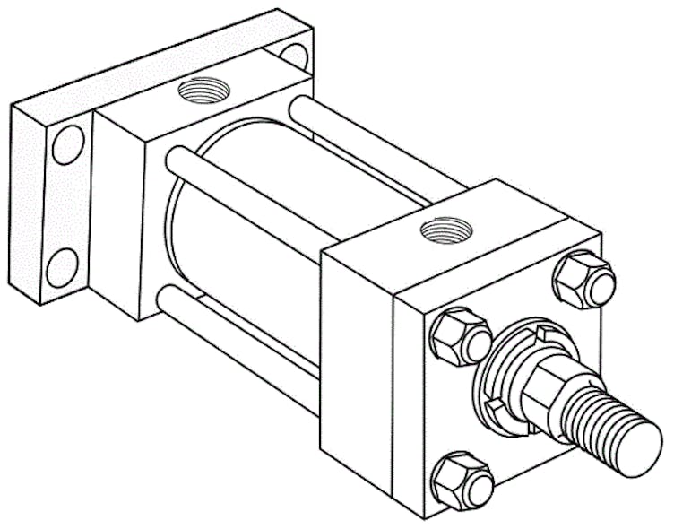

Mounting styles. There are basically three mounting styles. Load, speed and cylinder motion are the parameters that help determine which is best. For example, fixed and pivot mountings absorb forces on the cylinder’s centerline, the preferred way for mountings to handle the thrust or tension. These two types of mountings can usually be medium- or heavy-duty. A third style, fixed, supports the entire cylinder on its mounting surface below the cylinder’s centerline rather than absorbing forces only along the centerline.
Style J (NFPA MF1)
Style JB (NFPA MF5)
Style H (NFPA MF2)
For mounting cylinders, the best practice is to use a mounting style that absorbs forces on the cylinder’s centerline. If the piston is rod is primarily loaded in tension (pull), use head end mountings such as Style J and JB. If, however, the piston is primarily loaded in compression (push), use end cap mountings such as Style H.
Several standardized mounts within these styles give engineers alternatives for meeting application requirements. NFPA tie-rod cylinders, for example, are used in most industrial hydraulics and are typically mounted using trunnion-style heads and extended tie rod caps and/or head end styles; flange-style heads; side-lug and side-tapped styles; spherical bearings; and cap-fixed clevis designs. Most mounting options are available for single-acting and double-rod cylinders.
The purpose of the mount is to absorb forces, stabilize the cylinder and improve performance. For rods loaded primarily in compression (push), cap-end mounts are recommended. For those in tension (pull), head-end mounts are preferred. The amount of tension or compression determines piston rod diameter. The amount of pull or push determines the bore diameter.
Every mounting type comes with its own benefits and limitations. For example, trunnions for pivot-mounted cylinders won’t work with self-aligning bearings where the small bearing area is at a distance from the trunnions and cylinder heads. Self-aligning bearings would introduce bending forces that could overstress the trunnion pins.
Many applications might seem like they need atypical mounts, but most can be handled by existing styles with only slight modifications, which simplifies replacement and reduces costs.
