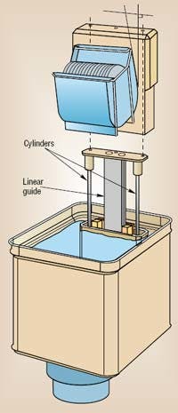

Processing equipment used in the fabrication of semiconductor integrated circuits lowers and raises a cassette of silicon wafers into a rinse tank. Each cassette can contain up to 25 wafers etched with patterning for advanced- memory or microprocessor components. A full cassette of wafers can be worth more than $1 million, so smooth, precise, and reliable vertical motion is essential.
Water-powered cylinders stroke 14-lb elevator assembly with cassettes of silicon wafers into deionized-water rinsing bath. Cassettes are tilted 4° to keep wafers registered to left side.

Although Airpel cylinders performed well during Strasbaugh’s initial tests, the elevator assembly did not quite meet the stringent motion requirements. Friction in the linear-guide mechanism and the variation in loads between full and empty cassettes resulted in motion that still was too irregular. Halley decided to see if he could actuate the CMP cylinders with water and capitalize on its incompressibility to achieve the smooth motion he wanted.
On Symphony chemical/mechanical polisher, water-powered cylinders smoothly lower blue cassettes of expensive silicon wafers into deionized-water rinsing bath.
This decision presented another problem. To meet the cleanliness requirements of the CMP machine, pressurized deionized water had to be used to drive the cylinder. And deionized water tends to corrode many materials. In particular, it eats aluminum pretty quickly. To circumvent the corrosive effects of the deionized water, Airpot made some design modifications on the standard Airpel. These amounted to replacing the nickel-plated aluminum piston couplings and cylinder heads with stainless steel components. To test the modified cylinder, Strasbaugh used a 5-lb load and canted it at a 4° angle, adding side loading to exaggerate wear potential. With raise/lower speed set at 1 in./sec, the modified, water-powered Airpel was cycled more than a million times with no degradation in travel rate. (A small amount of deionized water leaked past the gap around the piston and was collected in a drain pan for disposal.) Testing on the actual elevator assembly followed, and the water-actuated cylinder met all design and performance specifications.
