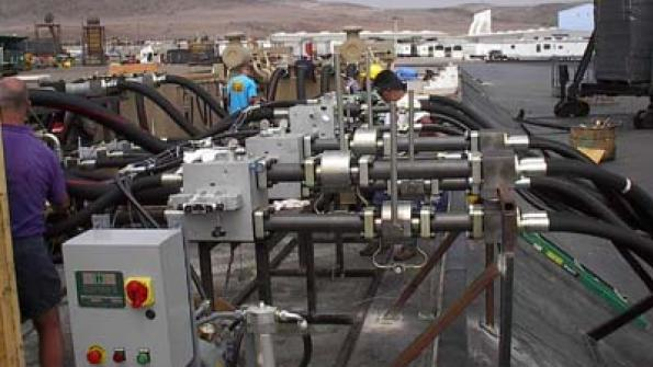

With the rocky coastline of Baja, Calif., as a backdrop, the main hydraulic valve stand features four Bosch Rexroth custom high-flow manifolds and six Bosch-Rexroth 4WRZ25 proportional valves. Click on image for larger view.

The central hydraulic system, which provided power to the cylinders on the gimbal, consisted of two 750-hp diesel engines, each driving four Rexroth AA10VSO140 pumps. These systems produced up to 500 gpm at 3000 psi to bring the gimbal's complex motions to life. Bosch Rexroth designed and built four custom high-flow manifolds for the project (two manifolds for the heave axis and one each for the pitch and roll axis).
These manifolds were machined to mount a total of six Rexroth 4WRZ25 proportional valves, which were driven by Rexroth VT11011 analog driver modules. The manifolds also included Sun Hydraulics anti-cavitation valves and relief valve cartridges. Plumbing from the HCI system to the gimbal was done through two headers (pressure and return) that were custom built in HCI's Walnut facility. Everything was tied together with hundreds of feet of 2-in. high-pressure and return hose supplied by Gates Corp.
