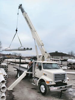

When an extra measure of stability is called for, outrigger cylinders with electronic position feedback add an extra level of safety.
Manitowoc’s A-frame outriggers in its National Crane product line provide electronic position feedback to ensure the equipment stays stable.
It’s not unusual for cranes to reach 100 ft or more into the air at major construction sites. Traditionally, cranes are transported to a work area and assembled on-site. More recently, as truck-mounted cranes become bigger and more powerful, they have found favor because they are quicker to set up than traditional cranes. Truck-mounted cranes have a telescoping hydraulic boom mounted on commercial truck chassis. Their portability and lower setup costs have led to their widespread use at construction and utility sites around the world. But as loads get heavier and lifting distances become higher, designers of truck-mounted cranes must provide the stability to ensure that safety remains the top priority.
Truck-mounted cranes use outrigger systems to ensure stable operation. The outriggers extend from the main body of the truck and contact the ground several feet away from the truck. This distributes the crane’s load over a much larger area, thereby increasing stability. Manitowoc Company Inc., Manitowoc, Wis., takes this a step further by using smart cylinders in the A-frame outrigger systems of its National Crane line of truck-mounted cranes. The crane’s hydraulic system is driven from a power takeoff on the truck’s transmission. The crane operator then runs all crane functions through a series of lever-operated valves at a control station.
An important function for lifting, moving, and lowering heavy loads is to ensure that outrigger beams are properly positioned. The outriggers are attached to the truck frame and are extended downward by hydraulic cylinders at an angle to create an A-frame structure that is wider at its base than at the top. This provides a stable framework to level and support the loaded and extended crane.
