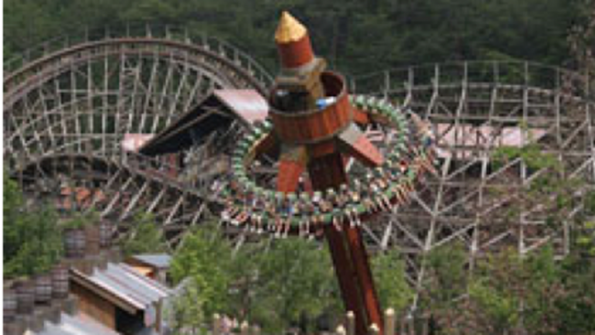

Dollywood’s Timber Tower propels riders skyward, where they may revolve around the attraction’s central axis, pivot to less than 30° from the ground, plunge back toward the ground, or any combination of these. Hydraulics provides the high force an precise control required for many of the motions.

Among the newest major attractions at Dollywood, Pigeon Forge, Tenn., is Timber Tower, a fixed ride that opened in 2006. Designed and built by Huss Maschinenfabrik GmbH & Co. KG, Bremen, Germany, Timber Tower is the first of its kind in North America. A 27-ft diameter passenger gondola carrying as many as 40 people rises 65 ft skyward before it plummets downward. The tower pivots to 30° from horizontal and features dual rotation — the gondola rotates at up to 11 rpm around the tower itself, and the ride base also rotates.
