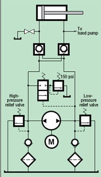

Battery-powered motor with overload protection drives bi-directional gear pump.
Mounted under the vehicle, a double-acting hydraulic cylinder — supplied from a compact Oildyne power unit with reversible locking circuitry — generates over 4000 lb of force while an independent, patented cable-and-pulley arrangement keeps the room aligned during movement. Cylinder strokes from 24 to 44 in. are typical, and installation is uncomplicated. A positive mechanical stop system, located on the cylinder rod, assures that force is only applied to the room during movement. This positive stop is accurate to within thousandths of an inch and should not need adjustment over its lifetime — even if the frame rusts or is not properly lubricated. Once the room reaches full extended or retracted position, loadholding checks in the hydraulic circuit maintain it there. This keeps the room's weather seals from relaxing to allow any potential leakage, while the room structure is not stressed or forced to move past its travel limit.

The Hydra-Sync system is not damaged by continued running after the room has reached full travel in either direction. The room stops exactly where it should, and the pump simply recirculates oil internally. If electric power is lost, an integral manual pump can retract the room.
