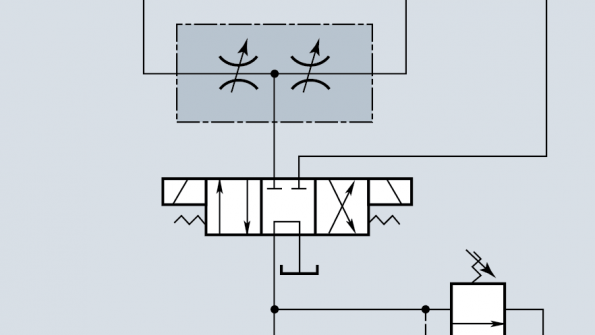

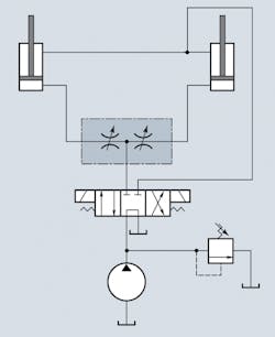

Valve-type flow dividers
Schematic representation of a flow divider valve being used to control two cylinders. There is no provision within the circuit to allow for easy or simple hydraulic re- synchronization.
Flow divider valves are probably the most common type of component used for synchronization, both in open- and closed-loop hydraulic systems. Usually, these flow divider valves consist of two or more pressure-compensated flow control (PCFC) valves within the same envelope. These flow control valves are designed to split and/or combine the incoming flow according to a predetermined ratio. In most cases, the dividing ratio is 50/50, and the combining ratio is one to one.
Advantages — This style of divider offers a great deal of design flexibility: the function can easily be integrated into other or multiple components (valve blocks, valve and hydraulic manifolds, stack-type valves). It is also easy to build a simple on-off function into this design. This is typically accomplished by plumbing a basic two-position, two-way valve, or a two-position, three-way valve in parallel with the divider itself.
The valve-type divider can be a discrete component. As such, a remote mounting location or position may facilitate design and manufacturing. It is easy to build a hydraulic re-synchronizing feature into this design by virtue of a steering or makeup orifice. Lastly, this design offers the ability to control and operate both linear and rotary actuators.
Disadvantages — The valve-type flow divider/combiner is an additional component that must be added to the system above and beyond the cost of the other components required. There may also be other miscellaneous incremental costs associated with this approach (additional plumbing, etc.). Historically, the accuracy of valve-type flow divider/combiners has not been as precise as that of external-gear rotary units or re-phasing type cylinders. Other issues include an inability to transfer power and the need for additional space. Also, if a high degree of certainty regarding synchronization is desired, a mechanical connection between the actuators would be necessary.
