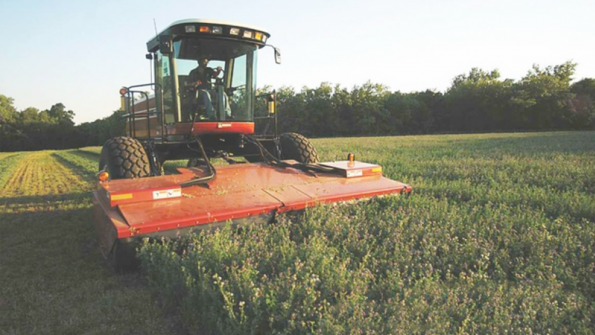

Figure 1. Windrower header height control on this harvester is accomplished by using rephasing cylinders in series. Photo courtesy AGCO Corp.
Rephasing cylinders are typically used in one of two operating modes: series or parallel.
Series mode — In this mode, the bore and rod diameters of the cylinders are of a size such that all cylinders extend or retract an equal distance when fluid flows into the first or last cylinder in the series. This type of circuit has a wide range of functions on many different types of machines.
Parallel mode — Here, as shown in Figure 2, the bores and rod diameters of the two cylinders are the same. Therefore, Cylinder A will extend the same amount as Cylinder B retracts when fluid enters the cap end of Cylinder A. Similarly, Cylinder A will retract the same amount as the right cylinder extends when fluid enters the cap end of Cylinder B. This type of circuit is typically used for the steering function on a mobile machine.
