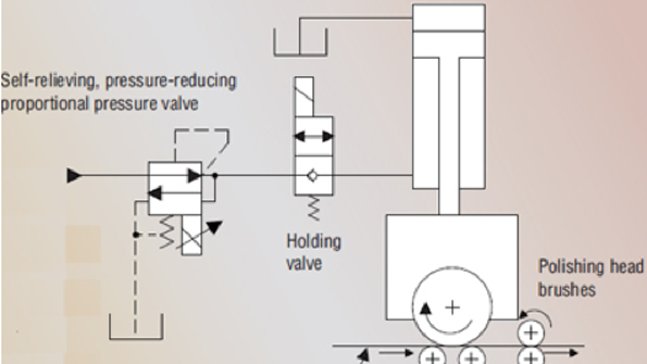

A steel processing plant uncoils 8-ft wide stainless steel coil stock and runs it through a polishing machine. It prepares the steel for use by manufacturers of appliances, such as refrigerators. The processing plant rewinds the finished product, adds ...
A steel processing plant uncoils 8-ft wide stainless steel coil stock and runs it through a polishing machine. It prepares the steel for use by manufacturers of appliances, such as refrigerators. The processing plant rewinds the finished product, adds protective paper between the coils, then ships them to the customer.
The circuit shows a polisher machine at a steel processing plant, where reject problems were becoming a problem.
The steel processor upgraded its 1980 vintage mill late last year. Part of the upgrade was to replace an old hydraulic system with proportional control and state-of-the-art technology for polishing flat steel stock. Once the processor was up and running, a few problems cropped up, most of which were solved with minor fixes — except for one. The hydraulic schematic shows the polishing circuit believed to be causing reject problems when a short jolt or bump was experienced during the continuous positioning of the mechanically driven polishing heads.
The circuit design incorporated a single cylinder with a self-relieving, pressure-reducing proportional valve to provide pressure to the rod side of a single-acting cylinder. When operators wanted the cylinder to fully retract, they provided a maximum signal to the valve, producing enough pressure to raise the piston rod. When they wanted the piston rod to extend, they sent a signal to the proportional valve to lower the rod-end pressure by allowing the weight of the polishing heads to extend the cylinder. The proportional signal also provided a counterbalance force, which acted against the polisher heads’ weight, thus applying the correct force needed for producing the correct finish on the steel.
When the operators determined that the surface finish of the coiled steel called for higher or lower pressure on the polishing heads, they made a slight adjustment to the proportional signal to the valve. About half the time the adjustment made the necessary correction without quality problems. Other times, however, a pressure bump seemed to create a defect in the coil. They noticed it usually occurred when their adjustment added more polisher head force against the coil stock.
Maintenance people replaced the proportional valve with a new one, but that had no effect. They could not find any mechanical binding, so they called in an electrical engineer. He felt it was a hydraulic problem because the electrical signal to the valve was clean and consistent in both the increasing and decreasing mode.
The problem did not seem to occur with increasing pressure, but reared its ugly head when pressure decreased. The operator turned the problem back over to the machine repair group, which did not know what to do next. Do you?
