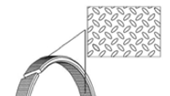

Polymer bearings with a teardrop pattern help form a fluid film under the seal.
To minimize the effects of heat, cylinder manufacturers should ensure proper alignment to uniformly load the sealing system, minimize external heat sources, cool the fluid, and ensure adequate fluid exchange near the seal.
Seal suppliers should investigate bearings and seals. For bearings, ensure the design, material, and location relative to the seals will handle the heat, limit additional heating from bearing friction, support the seals, and potentially aid in forming a fluid film under the seal. For example, some polymer bearings use a “teardrop” pattern to help form such a film.
