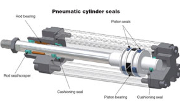

Pneumatic cylinders are precision-engineered systems where numerous individual components must work together for the actuator to function properly. Good seals are essential for low leakage and long life.
Pneumatic cylinders are a valuable and preferred option for many linear-actuation applications, combining long life, low maintenance, and ruggedness in an economical package. On the surface they might appear to be simple devices. In reality, however, pneumatic cylinders are precision systems with a number of engineered components that must work together for the actuator to function properly.

Sealing-system basics Seals are critical elements in cylinder design because they must balance performance and life with cost by: • Preventing unacceptable amounts of internal fluid from leaking out or external fluid from getting in. • Keeping static and dynamic friction within desired specs. Too little friction can mean not enough force to seal; too much leads to excessive heat, energy loss, and wear. • Having an acceptable working life. • Meeting total system cost demands.
One consequence of playing such a critical role in cylinder performance is that seal failures often mask bigger system issues. Seal failures are often the first obvious sign of system problems, as many times the root cause of failure lies with bearing, side-load, or misalignment issues.
The basic mechanics surrounding seal operation involves minimizing the clearance gap between mating surfaces, which separates fluids and maintains the required pressure differential. In many cases seals rely on interference and compression of elastomeric materials, springs, and other loading elements to create an initial stress. Designs also use other available sources of energy, such as fluid pressure, thermal effects, and hardware motion that help assist in loading the seal material. The result is the right fluid-film thickness control for optimum leakage, friction, life, and system cost.
