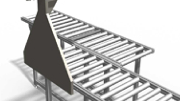

Figure 1. This rendering shows the Tolomatic BC2 actuator where it is located in the overhead beam in this pull-off station. It operates the large triangular paddle at the right. Upon a signal from a PLC, the actuator pushes the parts box to the left conveyor line.

“In Hytrol’s overhead diverter design, the actuator has to move a large triangular paddle that pushes boxes weighing up to 150 lb,” says Holloway. “This can create very high bending moments on the actuator’s carriage and guide bearings. The BC2’s carriage has a very robust bearing system with higher side-load capacity than other actuators in its class, resulting in greater capacity and longer life. When designing for very high bending moments, sometimes we specify dual carriages on the actuators to distribute the forces.”
