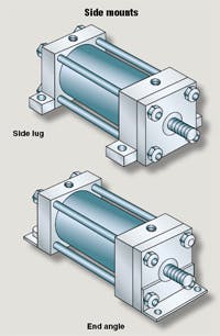

Side mounts
Cylinders with these mounting styles have lugs on the sides or ends of the end caps or side tapped holes for flush mounting. These mounts may be the easiest to use, but they should be well aligned and the load supported and guided for long service life.
Because the plane of their mounting surface is not through the centerline of the cylinder, side mount cylinders produce a turning moment under load. This moment tends to rotate the cylinder about its mounting bolts. If the cylinder is not well secured to the machine, or the load is not well guided, destructive side loads may be transmitted to the rod gland and piston bearings. To avoid this problem, side mount cylinders should have a stroke at least as long as the bore size. Heavy loading tends to make short stroke, large bore cylinders sway on their mounts, especially if they have side lugs, end lugs, and end angle mounts. Also, mounting bolts may be subject to increased tension in combination with shear forces.
Pivot-mount cylinders absorb force along the centerline and actuate loads through an arc.
Side mount cylinders depend on bolt strength and the friction of the mounting surfaces in contact with the machine to absorb the cylinder forces. The torque applied to the mounting bolts should equal the manufacturer’s recommended tie rod torque.
For heavy or shock loads, hold side mounted cylinders in place with a key or pins to prevent shifting. A shear key — consisting of a plate extending from the side of the cylinder — can be supplied with most cylinders, provided a keyway can be milled into a machine member. To absorb the major loading, maintain close tolerances (0.001 in.) between keys and keyways, and position the key at the rod end with the load in tension and at the cap end with a thrust load.
Side lug mounts are designed to let dowel rods pin the cylinder to the machine. When used, install pins on both sides of the cylinder but not at both ends.
Cylinders with offset mounts tend to change length and sway under load and temperature change, so tubing connected to a cylinder cap port will be subject to that resulting force and motion. If such a cylinder is rigidly plumbed, it will eventually leak. Offset mounts often require stronger machine members to resist bending, so also consider the rigidity of the machine frame.
