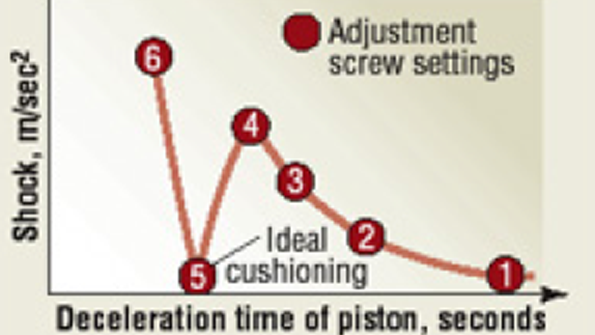

Figure 1. Every cylinder has a single setting for ideal cushioning for a given load and operating pressure. Too much cushioning increases the time it takes for the piston to reach the end of its stroke; too little cushioning increases end-of-stroke impact shock.

Figure 1 illustrates what can occur when the adjusting screw is opened, with all other parameters being constant. Starting at point 1, which represents the initial factory setting, opening the adjusting screw a turn at a time moves the setting to the left. During the first two to three adjustments, the deceleration time becomes progressively shorter, but the end impact becomes correspondingly higher. The normal reaction at this point is to stop, and return the adjusting screw toward the original setting to reduce the increasing shock.
However, ideal cushioning is achieved by continuing to open the screw an additional one to two turns. At some point, the end impact reaches its minimum, point 5 in Figure 1. Continuing to open the adjusting screw will cause end impact to suddenly increase substantially without a significant reduction in deceleration time. So at the ideal pneumatic cushioning point, not only is end shock minimized, but deceleration time is also reduced, which translates to shorter cycle times. A 20% to 40% reduction in total cycle time is not unusual when ideal cushioning is achieved.
