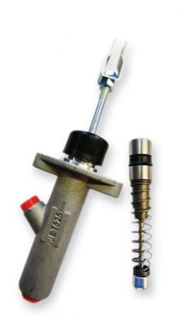

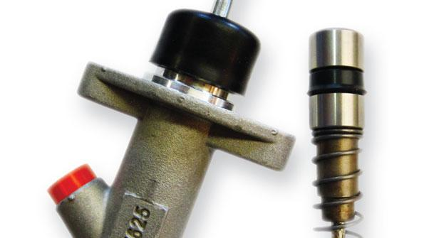

Figure 1. Basic master-cylinder components
Under ideal conditions, particularly linear loading, it was shown that existing master-cylinder design is sufficient. However, subsequent testing under side loading showed that the current design is susceptible to damage. We found that the major cause of damage from side loading is the steel rod wearing against the aluminum cylinder bore. The wear patterns created in testing are quite similar to those observed on field returns. The design and testing of a nylon cap on the rod end showed that side-loading damage can be virtually eliminated. Implementing this solution will result in a product with a longer life.
Master cylinders are a common hydraulic component used in brake and clutch systems to generate hydraulic pressure from a nonhydraulic pressure source. The master cylinders tested in this experiment are generally used in a fail-safe brake system on forklift trucks. In such a system, brakes are spring applied and released by depressing the brake pedal.
Figure 2. Colinear (top) and side-load push -od configurations.
A master cylinder for this application typically is comprised of a cast-aluminum body with a machined cylindrical bore and various ports, Figure 1. A piston assembly is inserted into the body and is actuated by applying compressive force to a steel push rod. Push-rod diameter, cylinder bore, and surface finish are critical for the piston to generate pressure without leaking. The master cylinder push rod is attached to the body via a washer and snap ring. The push rod is designed to allow deflection of ±5° from the main axis of the part. This allows for linkages and mounting configurations that are not colinear with the cylinder. When the push rod is not colinear with the cylinder bore, side loading, Figure 2, is generated.

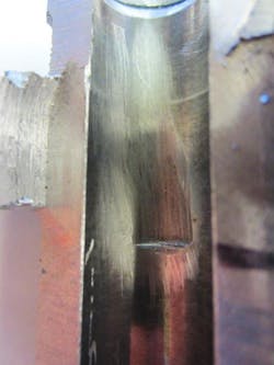

Figure 3. Master cylinder returned from the field shows side load damage.
Figure 3 typifies side-load damage found on returned master cylinders. The cylinder has been cut open to better see the damage, which includes severe scratching on the bore wall. The damage is localized on one side of the cylinder bore, indicating a side load. This ruins the machined finish on the inside bore of the master cylinder, which is necessary for the piston seal to work properly. Moreover, the wear leads to the release of small particles of aluminum into the system, further damaging the piston seal or other hydraulic components.

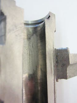

Figure 5. Sample 4 bore shows damage after 10,881 side load strokes.

Samples 4 and 5 were subjected to side loading and did not have any design modifications to reduce side-loading damage. Consequently, both exhibited severe side-loading damage similar to that found on field returns. Figure 5 shows the bore damage to sample 4.
The significant bore wear is due to the push rod rubbing on the same area as a result of a repetitive side load. This damage causes aluminum grit from the bore wall to enter the system. Dimensional deformation causes the seal to not seal properly, resulting in brake fluid bypassing and leaking. Sample 5 exhibited similar damage.
Both samples showed that the action of the push rod wearing on the bore wall created the side-load damage. The steel push rod, significantly harder than the aluminum, made it the largest contributing factor to the wear observed.
