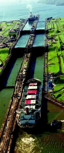

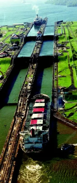

Ships from all over the world travel through the Panama Canal every day. In an average year, more than 14,000 vessels on international voyages (representing approximately 4% of world trade) pass through this famous waterway. In 1998, the Panama Canal Authority decided to accelerate its mission to upgrade the Canal to meet projected demand increases. The goal was to modernize cumbersome mechanical systems and streamline operation and maintenance.
One key area identified for upgrade in the $700 million project was the waterway's trademark lock operating system. The system's antiquated mechanical design was in need of a complete overhaul. As part of the modernization effort, Bosch Rexroth Corp.'s Industrial Hydraulics technology group was awarded a multi-year contract to manufacture new hydraulic systems for the Panama Canal locks' miter gates.
Hydraulic drives for lock operation
The Panama Canal is 50 miles long, connecting the Atlantic and Pacific Oceans. Winding through one of the narrowest and lowest areas of the isthmus' long mountainous terrain, the canal crosses the Continental Divide at an elevation of 85 ft above sea level. Travel through the canal by an average ship requires about ten hours.
As each ship is raised or lowered in the 110 1000 ft lock chambers, they are sealed in the lock on either end by miter gates. Rising stem valves and cylindrical valves allow water to be transferred from chambers with higher elevations to chambers with lower elevations. Each has mechanical linkages that connect to small gate-like structures that can block the passage of water through culverts at the bottom of the chambers.
Previously, all of the miter gates, rising stem valves, and cylindrical valves had been driven mechanically. However, over the last six years, Bosch Rexroth has systematically replaced the antiquated mechanical drives of all 80 miter gates with hydraulic drive systems — improving lock efficiency, functionality, and streamlining daily operations and maintenance.
