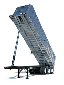

For example, assume a dump body needs to be tilted 60° in order to empty completely. If the body or trailer is fitted with a conventional rod-type cylinder — with a one-piece barrel and stroke long enough to attain that angle — the dump body could not return to a horizontal orientation for highway travel because of the cylinder's length, even when fully retracted. A telescopic cylinder easily solves this problem.

As with conventional cylinders the two basic types of telescropic hydraulic cylinders are single- and double-acting. Single-acting telescopic cylinders extend under hydraulic pressure and rely on gravity or some external mechanical force for retraction. Single-acting cylinders are used in applications where some form of load is always on the cylinders. The classic single-acting telescopic applications are dump trucks and dump trailers. Pressurized oil extends the telescopic cylinder to raise one end of the dump body. When pressure is released, the weight the dump body forces oil out of the cylinder, it retracts.
