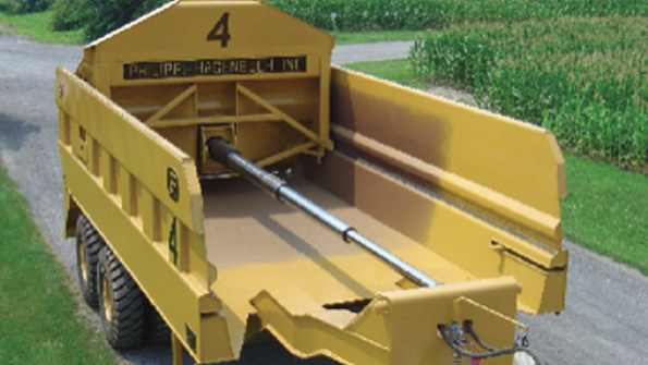

Innovative design of hydraulics from Prince Mfg. provide this truck from PhilippHagenbuch with multiple advantages over its conventional dump truck counterparts.
A particular challenge for this application is the horizontal mounting of the 3-stage telescopic cylinder. This orientation can produce side loads on the rods from the weight of the cylinder itself.

The key element of PhilippiHagenbuch's ejectors is a three-stage telescopic cylinder from Prince Mfg. Corp., North Sioux City, S.D. A second cylinder opens and closes the tailgate, and both cylinders are controlled through a single manifold.
Load ejection is under complete control of the vehicle operator. Typically, the operator pulls a lever, which routes hydraulic fluid to a double-acting, three-stage telescopic cylinder. The cylinder pushes an ejector blade that ejects the load from the back of the truck or trailer bed. A mechanical linkage between the cylinder and the tailgate controls opening and closing of the tailgate automatically.

In contrast, Philippi-Hagenbuch's telescopic cylinder is mounted horizontally. This means the cylinder must be double acting because gravitational force does not act in a direction to retract the cylinder. Furthermore, the weight of the cylinder acts radially, rather than axially. Left unchecked, this radial force could produce side loads on the cylinder that could accelerate rod and bearing wear. Therefore, the cylinder contains oversized rod bearings to prevent premature wear.
More importantly, horizontal orientation can cause cylinder stages to extend out of sequence. When this occurs, internal flow paths can be blocked, causing the cylinder to stall. To prevent this, Prince supplies Philippi-Hagenbuch with an alternative design with flow paths through tubes, rather than through ports on the sides of each stage.
