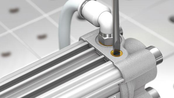

Cushioning in some pneumatic cylinders can be adjusted with a screwdriver, although cylinder strokes must be adjusted for both retraction and extension.

In contrast, adjustable cushioning helps optimize pneumatic cylinder performance during set-up and when loads or speeds change. Adjustments are made via a simple adjusting screw, which changes the cross-section and flow through the cushion’s exhaust port. Usually, a screwdriver is all that is needed for proper cushioning adjustment—although cushions must be adjusted both for cylinder extension and retraction.

For example, with adjustable cushioning in the current generation of Aventics ISO pneumatic cylinders, only a few turns of the screw are sufficient to adjust the cushioning to the workpiece weight and movement dynamics. The results can be dramatic. Optimally adjusted cushioning can shorten braking time by up to 75% compared with pre-adjusted systems. This, in turn, means significantly shorter cycle times and higher productivity.

Then, much like the adjustable cushions discussed previously, ideal cushioning adjustments are made with a simple screwdriver, permitting a free outlet flow adjusted so the piston stops right at the end cap with zero speed. In machines with banks of cylinders, pistons are adjusted one at a time, with the first one used as a standard to conform to a maximum speed for a given pressure and cylinder load.
