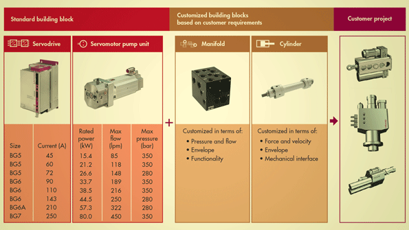

To help machine builders incorporate EHA into a new generation of machines, Moog is combining standard building blocks, such as servodrives and a servomotor/pump combination, in typical sizes with a manifold and cylinder that designers can customize to an application’s exact needs (Fig. 4).
Using EHA technology saves a substantial amount of energy via power on demand, while the dynamic performance is equal to conventional EH or EM systems. Such a self-contained axis leads to a decentralized machine axis design, which optimizes axis performance. EHA is environmentally friendly, easy to install, and the interfaces are identical to EM solutions; the functionality is far more flexible and the achievable forces are greater.
The building-block components are adapted to the specific requirements of an EHA application. For example, the motor-pump unit includes a mechanical interface that allows a direct mounting to a cylinder or manifold, and the pump can operate in the four-quadrant operation mode. And with EHA, machine builders can choose the right technology for an application without incurring integration hurdles. It’s no wonder EHA is helping machine builders’ designs soar.
