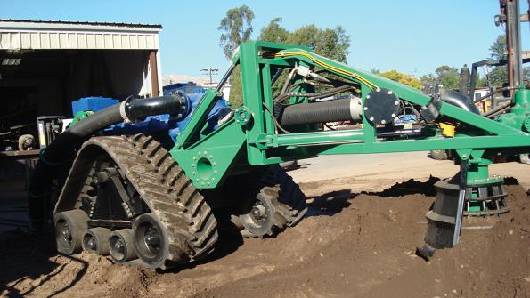

Makeup of the machine
TMT’s Sub-Dredge is a rubber track based platform approximately 16 8½ 7½ ft. A main dredge pump i s mounted between the tracks with its suction line routed to the front of a swing boom and angled down into a rotating head. The boom on the front swings 6 ft to the left and right while the pump removes sediment at up to 350 yd3/hr.
The operator can watch the operation via two submersible cameras mounted on each side of the boom. (The Eddy Pump produces minimal turbidity; otherwise, the cameras would be virtually useless.) Other sensors monitor the orientation of the machine and automatically make changes as required. The machine can also be equipped with positional software that locates the dredge on a virtual map for tracking and recording progress in real time on a monitor.
The operator sits in a joystick chair on a floating or land-based platform and watches a PLC touch screen, the cameras, and the positional computer monitor. The swing is activated by selecting automatic or manual mode on the touch screen and shifting the joystick left or right. To advance the machine to the next position, the operator pushes forward on the joystick controlling the track drives. This joystick also controls drive direction.

The swing system uses two 4-in. bore, 32-in. stroke cylinders with 2-in. stainless steel rods. The lifting system employs two 4-in. bore, 24-in. stroke cylinders, also with 2-in. diameter stainless steel rods. The digging head system is powered by a low-speed, high-torque radial-piston motor driven by a closed-circuit, variable-displacement pump. If so equipped, two pipe line valves are controlled by a 2½-in. bore, 8-in. stroke cylinder with 1-in. rod.
