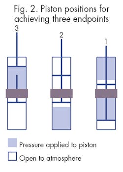

Three-position cylinders. You can get three or more rod positions from a single cylinder. Many cylinder styles are offered with three position options.

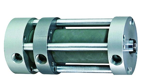

The short-stroke tie-rod cylinder (Fig. 1) is essentially two cylinder bodies combined in a single package. You can specify the same or different stroke lengths to set your work positions as required (Fig. 2).

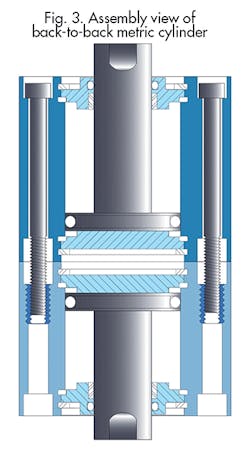

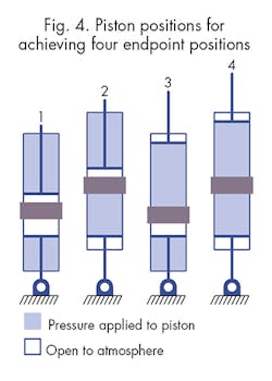

Four-position cylinders. You can also get numerous cylinder styles in back-to-back configurations that enable positioning at up to four endpoints (Fig. 3). As the name implies, two single-rod cylinders are assembled with their back endcaps attached. By anchoring one rod end and allowing the cylinder body to “float,” four distinct endpoints can be obtained (Fig. 4).

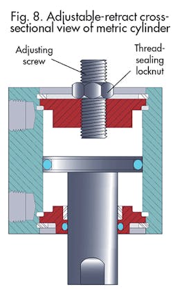

Adjustable retract stroke. An adjusting screw with a thread-sealing locknut mounted in the rear endcap (Fig. 8) provides a simple, yet rugged adjustment of the cylinder stroke in the retract direction. A fine thread on the adjusting screw will provide precision adjustment. Adjustable retract strokes are offered as optional features for many cylinder styles.

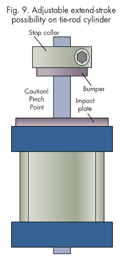

Adjustable extend stroke. It is possible to use the back end of a double-rod cylinder to adjust the extend stroke. A stop collar, bumper, and some kind of impact plate could do the trick. However, if taking this approach, use caution and consider a safety cover to avoid leaving the pinch point exposed (Fig. 9).
