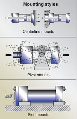

Cylinder mounting styles fall into three basic groups.
In a perfect world, cylinders would align exactly with their loads, but that’s often not the case. By far the major cause of premature cylinder failure is side-loading away from the cylinder centerline which wears the bearings and seals. Yet this type of failure can be minimized by selecting the correct cylinder and installing it properly. Too often designers overlook simple but important steps — such as specifying the mounting style that best suits the cylinder and its installation.
Cylinder mounting styles fall into three major groups. Here’s a closer look at each.

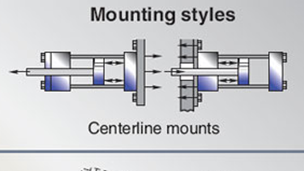

Centerline mounts
The best way to support a cylinder is along its centerline. Fixed mounts that absorb force along the cylinder centerline, including extended tie rod, centerline lug, and flange mounts, should be used whenever possible.
Extended tie-rod mounts are available at the rod or cap end of the cylinder. Because they are symmetrical, any thrust or tension forces on the piston rod are uniformly distributed about the cylinder centerline. The rods are designed to withstand maximum internal rated pressure, so this mounting style can handle thrust or tension forces at full rated pressure. While considered to be one of the best mounting styles, extended tie-rod mounts often are passed over by designers.
Centerline lug mounts are another style of fixed mounts. The mounting lugs hold the cylinder in place while friction between the lug underside and the machine surface on which it rests prevents the cylinder from moving laterally. When used at high pressure or when subject to shock loading, the lugs should be dowel pinned to the machine surface. For thrust loads, pin both lugs at the cap end. For tension loads, pin both lugs at the rod end. Never pin both ends.
Flange mounts
Flange mounts are also considered to be fixed-centerline mounting styles and are among the best mounts for use on straight-line, force-transfer applications. Three types of flange mounting styles at each end of the cylinder are the head (rod end) or cap rectangular flange, head or cap square flange, and rectangular head or cap. Selecting the proper flange depends in part on whether the major force applied by the load will result in compression (push) or tension (pull) stresses to the piston rod. Cap-end flange mounting styles are recommended for thrust (push); rod-end flange mountings are recommended for tension (pull).

Pivot mounts
Lever-arm length and angle affect force transmitted from cylinder to load.
Pivot mounts also absorb force on their centerlines and should be used on applications where a dynamic machine member travels in a curved path. The two basic types are clevis and trunnion mounts. Both can be used on tension (pull) or thrust (push) applications at full rated pressure, except on long-stroke thrust applications where the piston rod’s column strength becomes the limiting factor.
Clevis mounts can be fixed to the cap or detachable. They provide a single pivot point for mounting the cylinder and, therefore, need a pivot pin with sufficient diameter to withstand the application’s maximum shear load. Clevis mounts can be used with the cylinder centerline vertical, horizontal, or any angle in between.

Side mounts

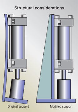

Strength of the machine structure may be a limiting factor in cylinder mounting.
Fixed mounts that do not absorb force on the cylinder centerline comprise the third group of mountings to consider. They include side lug, side tapped, end lug, and endangle mounts. Cylinders in this group mount on one side or edge of the head and cap and, as a result, the mounting plane is not through the cylinder centerline.
For this reason, side-mounted cylinders produce a turning moment as the cylinder applies force to the load. If the cylinder is not well secured to the machine, this turning moment will side-load the gland and piston. Large-bore, short-stroke cylinders tend to sway on their mountings, especially side, end lug, and angle mounts. A general rule to avoid these side-loading conditions is to select a stroke length equal to at least 1.5 times the bore diameter.

Also, consider design of the machine frame used to support these cylinders, because stronger members are frequently required to resist bending moments for heavy loads and high-shock conditions. Side-mounted cylinders should be held in place with a key or pins to prevent shifting. A shear key or thrust key can be ordered for most cylinders in this group. Obviously, a keyway must be milled in the machine member to use this mount. The key and keyway provide accurate alignment and take up the shear load.
