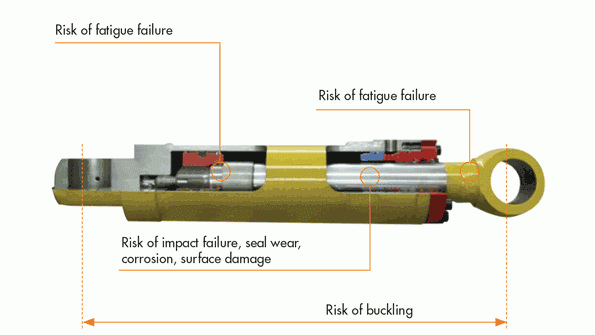

1. These are the principle parameters in hydraulic piston-rod design.

But to achieve these benefits, the rod material must be strong enough to maintain equal strength at the smaller diameter. Therefore, a key parameter in hydraulic piston-rod design is dimensioning against fatigue, buckling, and impact failure (Fig. 1).
