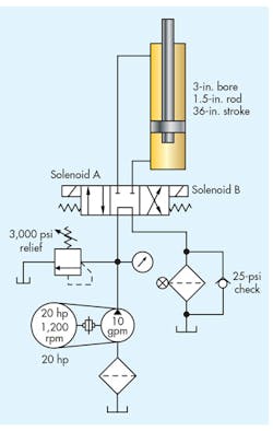

A hot dog machine utilized large tubs of raw meat, which were lifted and dumped into grinders using a simple hydraulic system. But when the meat was fully loaded to the top, it couldn't be lifted.
A packing house has a hot dog machine. It starts off with raw meat from large tubs dumped into grinders that feed the hot dog production line. After spices and fillers are added, the mixture is inserted into a casing material and cut to length. Then the raw hot dogs pass through an oven, and are subsequently wrapped and labeled. Finally, the packages are quick-frozen and packed into cartons for shipment.
The large tubs of raw meat are lifted and dumped using a simple hydraulic system (see schematic) consisting of a cylinder that lifts the tub up to dump the meat into the grinders. Over time, operators noticed that if meat was fully loaded to the top of the tub, the cylinder could not lift it.
The production crew changed the full-fill point to reduce the amount of meat loaded into the tub by the operators. However, this didn’t work as a quick fix, as the smaller amount of meat dumped into the grinders could not keep up with the speed of the production line.
A maintenance worker replaced a broken pressure gauge and found that the hydraulic-system pressure maxed out at only 1,700 psi, even though the relief valve was set at 3,000 psi. The 1,700 psi did not generate enough force from the cylinder to dump a full tub. However, when operators reduced the load on cylinder by only partially filling the tub, the cylinder operated at the correct speed.
Of course, the first thing the maintenance people did was replace the pump, only to have the same result. They verified that the relief valve was not relieving oil to the tank at 1,700 psi and that the cylinder wasn’t leaking oil from the rod-end hose.
What do you think was causing the problem?
