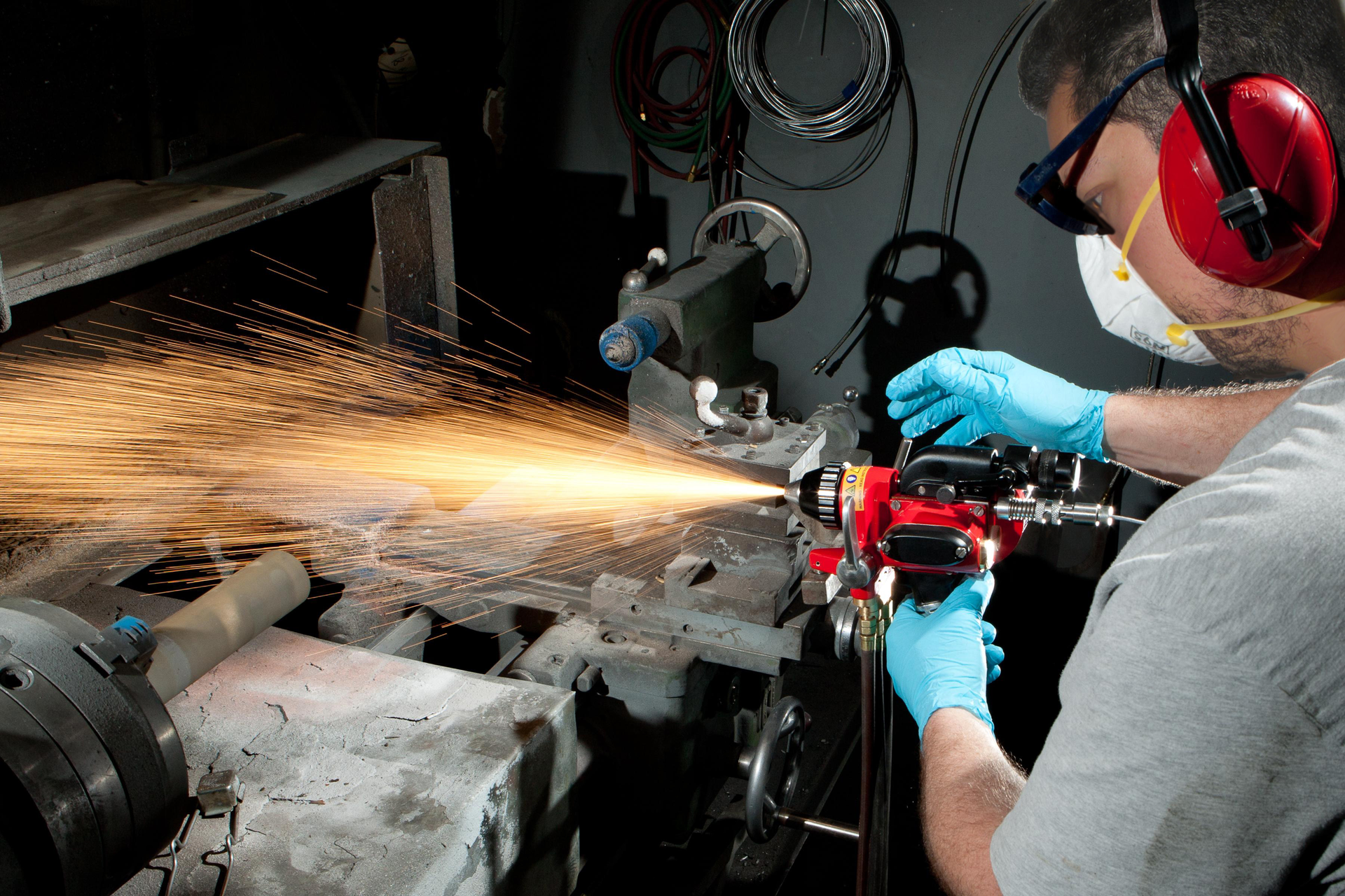

In HVOF guns, a mixture of oxygen and gaseous or liquid fuel is fed into a chamber where ignition and continuous combustion occur. The resultant hot gas exits through a converging–diverging nozzle. The jet velocity is supersonic at the exit of the barrel.  A powder feed stock is injected into the gas stream and accelerates up to 800 m/s. The stream of hot gas and powder is directed towards the surface to be coated. The powder partially melts in the stream and deposits upon the substrate with a resulting coating of low porosity and high bond strength.
In HVAF guns, spray powders are heated and accelerated by combustion products of hot compressed air and fuel gas.  Fuel gas can be propane, LPG with high content of butane, propylene, MAPP or natural gas.
A mixture of air and fuel gas flows into the combustion chamber through hundreds of orifices of a ceramic insert.  Initial ignition of the mixture by a spark plug results in heating of the insert above the auto-ignition temperature of the mixture. The hot insert continuously ignites gases, providing stable combustion in a wide range of air:fuel ratios and gas pressures. Air cools the gun, and this preheated air is used for combustion.
HVAF-applied coatings protect parts, vessels and structures against abrasion, erosion and corrosion and benefit surface restoration, conservation and preservation.  HVAF is also used for spraying the internal diameters of pipes in preparation for other processes through the application of a thin layer surface and coating stripping.
Combining the Two Processes
HVAF and HVOF have been merged into a single system (HVAF/HVOF) that offers the highest spray rates in the industry in either mode. The HVAF/HVOF thermal spray system uses air as the primary oxidizer and oxygen to elevate the temperature, thereby optimizing the process with breakthrough results. The addition of oxygen provides all existing HVOF owners and new prospects a reliable and less expensive coating with a high quality. Existing HVOF specifications can be achieved and exceeded using the convertible system. Users can achieve a 0.002-in. thick corrosion-proof coating that holds up under high pressure and can be polished to an RA 4 finish without grinding.
