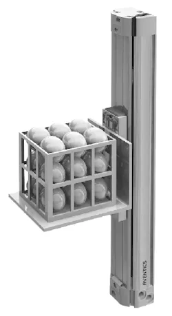

Rodless cylinders can be used in a wide variety of applications, including vertically mounted for uses such as parts elevators.

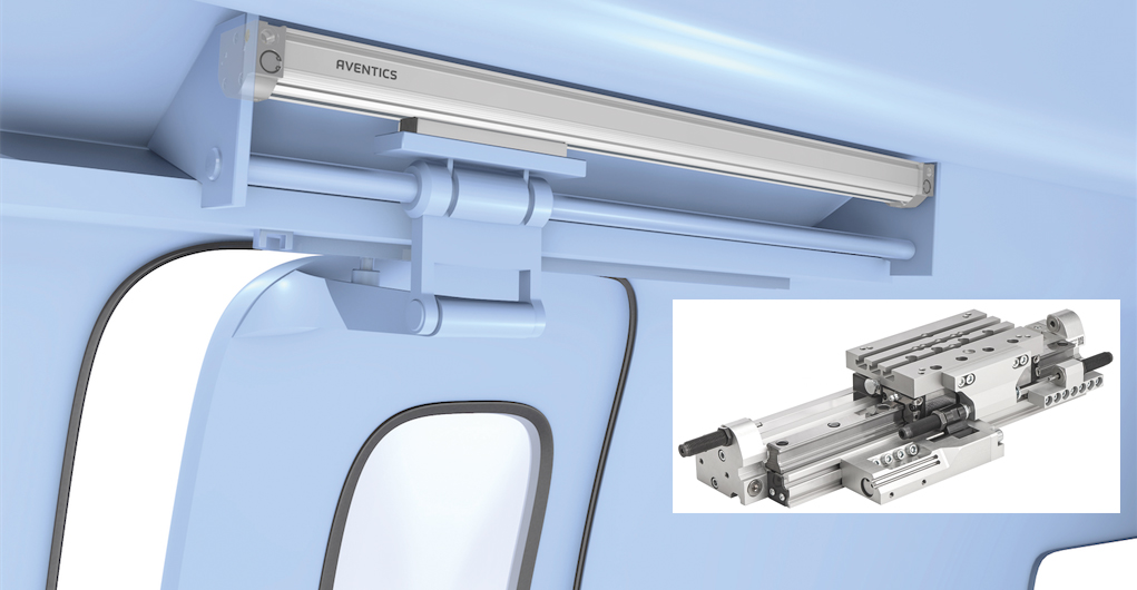

Application Spotlight: Moving Train Doors with Ease
The compact size and proven efficiency of rodless pneumatic cylinders make them excellent tools for applications beyond automation machines. For example, Aventics recently launched the RTC-TD: a rodless cylinder designed to move train, subway, and other transport doors weighing up to 90 kilograms.
        AVENTICS RTC-TD rodless cylinder shown in train door application.
There are specific requirements for this application: The cylinder needs to brake before reaching the door’s end position (particularly on closing) to prevent wear and ensure long service life for the drive and doors. Cushioning also minimizes the risk of passengers being trapped. On top of that, passengers should be able to open doors easily and quickly by hand in emergency situations.
Railway specialists at Aventics integrated cartridge cylinders into the end cover of their existing RTC rodless cylinder. These devices support the 3/2 directional exhaust, check-choke, and shuttle valves. The result: The drive is extremely vibration-resistant and is much more compact and lightweight than electromechanical and other pneumatic solutions.
The two-stage throttle with fixed throttle cross-sections is responsible for braking the door’s motion without any electronics or special controls. In the event of an emergency, such as a total power failure, the drive exhausts automatically to match the external air pressure, so that the door can be moved manually with ease.
The RTC-TD provides a lower-cost, nearly maintenance-free door movement solution, leveraging existing pneumatics systems already present on many transport systems.
